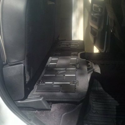

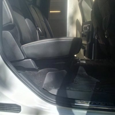

IMG_20180508_114256_hdr.jpg IMG_20180508_114345_hdr.jpg IMG_20180508_114425_hdr.jpg IMG_20180508_114508_hdr.jpg Apart from the kicker there is no plug and play simple drop in and as you know it loses you 1 side of the fold out floor. Keeping the load floor is not easy. I may be the only guy on the site that has pulled that off so far. But not perfect or cheap. Could also custom fit a box, but only a very few subs will give you a good chance of fillting it under the floor such as sundown SA-3 8s.

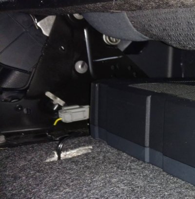

If your looking to retain the fold flat floor, put a Kicker Hideaway behind the back seat. There is probably room for two if one isn't enough thump for you...lol
I have one, it's not going to rattle your teeth loose but it does add to the low end.

I take back what I said about the Hideaway interfering with the fold flat floor. With it against the back wall of the truck, it stick out as far the grey plug on the seat bracket. I pulled the fold flat out long before I bought the Hideaway.
The Hideaway won't sit flat in the hole on the passenger side.

Wait, so you think the Kicker would interfere with the fold flat floor? Or wouldn't?
I don't think it will, that pic I posted above should give you a reference on how far the Hideaway comes from the back wall. The hinge for the fold flat floor is off to the left of the pic.
If you weren't so far away, I would say swing by we could try it.
