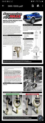

Don't know if it'll matter but this is the 2nd set i've seen that's facing a different way from their instructions (according to the labels they come with).
The label says "this side facing outwards" so they should look like this.
49895066031_466d149d00_3k.jpgUntitled by RAM RSM, on Flickr
Also with these bushings you don't want to have them squished up like the stockers. These things need to be a little on the loose side. the instructions are spot on, it takes if i remember 8-10 open threads on the bolts.
Here is a video that shows the orientation and the label i'm talking about. Again i don't know if it makes any difference or not but better be safe than sorry.

Appreciate the feedback.
Depending on which orientation of truck you have depends on how they install I guess.
I'll take a better photo of the instructions for you front and back so we can see the difference.
I assure you I installed them per the instructions
If you can read the top photo direction 3 states the orientation of the lower portion of the link.
3. Insert MaxxLink through lower control arm with the open end side facing outwards toward the wheel and hub assembly. ( Did I interpret this incorrectly?)

Found it!
So these suckers do install differently depending on which LCA you have. Since the attachment points are different from the RWD to 4x4. SuspensionMaxx allows you to download their install guides in pdf format incase you lose them.
This is Part# 1229L for RWD
The 4x4 install

Awesome. i was just looking as the instructions thinking maybe the 1229's will mount differenty. Sorry for the confusion :)

Appears there are two sets of instructions for the 1300L. I just installed mine this weekend and they have the opening on the sides, not front to back as the instructions posted show. I went out and looked at them again after viewing this thread and I must have a different version or something because it would appear its the only way mine could be installed. I'm going to have to call them this morning. I'll get some pics up when I get a chance as well.

Same here. I installed mine yesterday. Doesn’t seem like mine would go any other way. 25EBA3B8-9A8A-4CAF-9787-531873596B67.jpeg

Yup - just spoke with S-maxx and it's been confirmed. New design. New instructions. Was told to install per the instructions received in the kit and to disregard the online instructions. And yeah, I think after trying any other way you could be pretty sure they go only one way but now it's confirmed!
