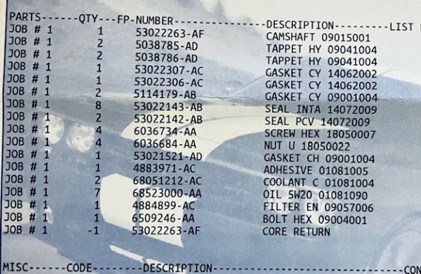

If it ends up being CAM/Lifter, I just had this done at the dealership under lifetime warranty, and this is exactly what they replaced. Tech said on a 2WD, this is a relatively easy job. My truck now runs like brand new.
