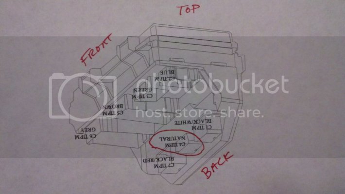

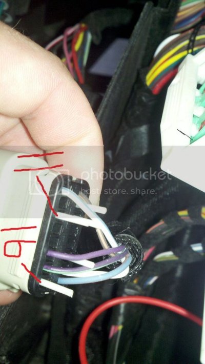

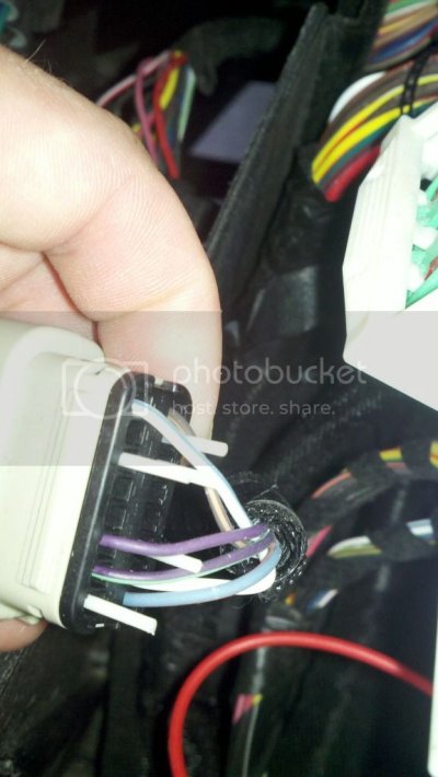

thats the tpms. This is what I found I pulled the light grey/natural color connector. im just waiting for my kit to come in so I can install it and hopefully it fires right up. I already have the switch and have the sales code installed. I was going one route with lighting then changed my mind.
top view
back side of plug. notice the white plastic sticks, they are in place of the fog wires and what ever else goes to this plug
top view
You put those sticks in right? Mine has wires in the 11/16 slots now. Mine also has more wires in there than yours but I have a slt.
Were there any wires in slots 11 and 16 in your plug?
Also how did that come apart?
Are you saying that pix I sent you of the module is the TPMS module?

if you have wires in 11 and 16 you must have the fog light wires somewhere up front. the white sticks where their. the pic you posted was the tpms I have the same thing on the drivers side. I'd do some poking around underneath the front end they must be there somewhere. it just had a red slider that pulled out or in (dont remember now) than you pushed down on the clip and it pulled out. I believe this connector is right behind the green connector. The connector is c4

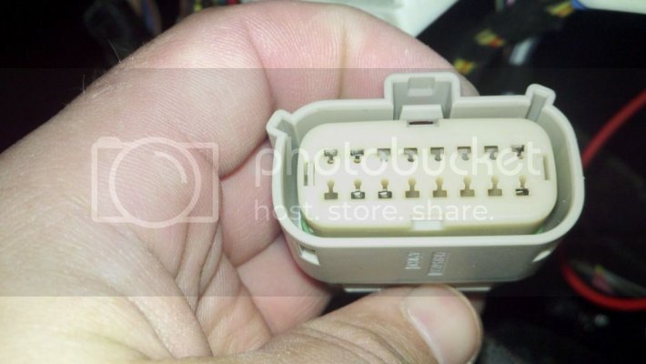

Oh yeah I know how to get it loose from the fuse box by releasing the red slider but I am wondering how you get it apart to put the wires in the slot?

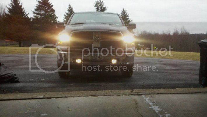

I got the wiring harness installed took about 5 min. all that is needed to be done once you have the c4 connection in your hand is pry up on the face of the connector and it will pop up the slide the 2 wires from the harness in 11/16 put everything back together. If you already have the switch and sales code installed you're all but done. I didn't end up using the fogs with the kit I bought some hella mini FF. It took about an hour to get them mounting with a little of persuasion to bend some of the factory brackets down a bit. Here's a pic of the lights.

Where did you get these foglights? I you have a part number?

I got this kit off of ebay from steve white automotive or dealership. It's a dodge dealership . the part number is 82211694AB

Come to think of it I never used the fogs I added in hella micro FF lights but used the wiring from the kit. As far as I know you don't need to modify anything to get the fogs to fit. I've since added added a factory front bumper with fogs
