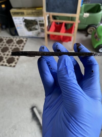

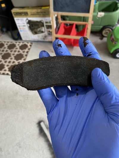

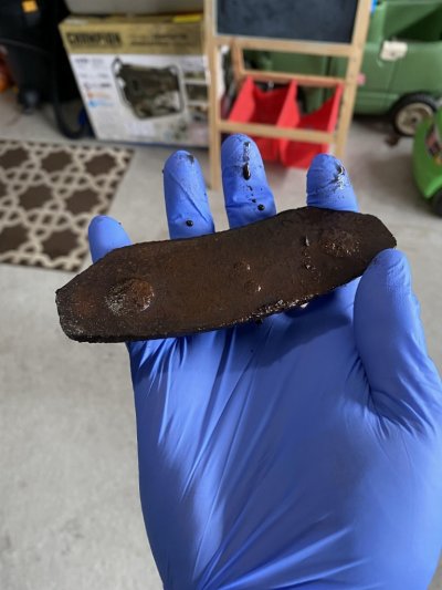

This is what I found.... I didn’t inspect rotors as I can’t really see them through my wheel and I can’t lift my truck with my current jack as it doesn’t lift my truck high enough. Father in law is bringing his over today. Brakes felt fine up until yesterday, however, I don’t drive it much these days and I haven’t towed my bot yet this year so I didn’t sense an issue. Plus, no weird sounds or anything

The ears would have to shear off for the whole pad to drop out, unlikely.
More likely the pad separated.
Either way the caliper pistons went past their travel range & probably damaged the seals.
Don't drive it until you know.

That looks like it rotted off from corrosion. It looks like you had a fair bit of pad left, but also one of your caliper slides is sticking so it's not wearing evenly. Based on the corrosion not surprising. My rear slides get stuck pretty regular from prairie mud and whatever they put on the roads in winter.

Usually you can just pull the slide pins and grease them. That picture you shared is only the pad material no backer plate which means corrosion separated it. New pads and grease the slides should be all you need
Edit: I’ll add that you won’t know till disassembly so I don’t shoot myself in the foot
