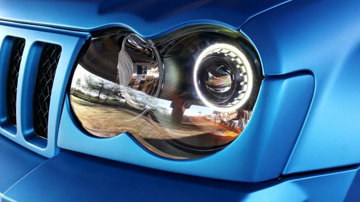

I have projector housings made by a ramforum member, pricy, but on par with my Audi HIDs (minus the adaptive feature that moves the housing with the steering wheel).

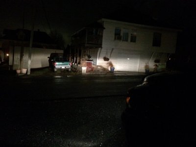

As long as you get a good set of hids (ddm tuning, the retro shop, the retrofit source) that have the reflector shield around the bulbs, stick with 35 watts, under 6000k, and re aim them after the install, you will be ok with them in factory housings. Is it ideal, no, but you will be fine. Most of the glare that people talk about with hids comes from dumb kids running around in civics with 55 watt 12000k hids in junk ebay housings. I had a set of ddm tuning hids in my 07 tacoma, 35 watts, 5000k, re aimed them after the install, and in 3 and a half years, never got flashed once. And I could see so much better. I can put up a pic on here of the beam pattern of them if I can find it. Modern headlights do a pretty good job at controlling light output. Now if you go and do a sealed beam conversion on an old cherokee or slap them into an old civic, yes you will **** off everyone on the road around you. I just could never justify it to myself to spend 1k+ on a set of headlights.

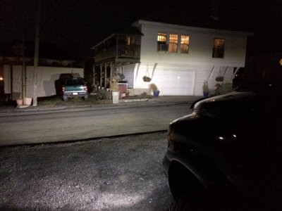

LED kit
That's only my fog lights in both pictures. The pic still doesn't do it justice as seeing it in person
