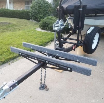

Some stuff U may want to review. Just FYI.

Or extend your boat trailer tongue and add bunks like above.

In Alberta it is legal to tandem pull trailers with your pickup. Towing two ball pull trailers is a bad idea and is not legal in Alberta. A tandem Fith wheel must be the front trailer and a ball pull in back with a frame attached hitch on the fith wheel. This arrangement also works far better for control and stopping.
The cradle is a great idea but you need to be very sure you get the layout, hitch weight and weight carrying capacity of the tonque right.
