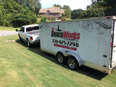

And as much as I hate to praise the 44-44, it actually worked well for me backing up a loaded trailer up a hill in my front yard in low without spinning a tire, pic dosent really do it any justice but I was a bit concerned about tearing up my new front yard
Often you do get lucky and it doesn't matter, but I did tear up the lawn just a bit recently maneuvering a 14 foot enclosed trailer with maybe 5000 lb inside. Nothing more than a little turf adjustment didn't correct.
