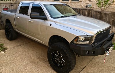

@jgruberman the Billies can augment any lift you go for. You can keep them maxed at 2.8, or as stated above drop them back down to get the height you are seeking. I went from stock (with a 3" rake) to level with Bilsteins, then added a Zone 4/3. I ran 305-55-20s and then went to 35s. I then went to a 6" Zone by swapping out the front strut spacers from Zone. (It's a BDS part but they are the same company). All the while I kept those Bilstein 5100s. Later, I added Iron Bull bumpers and a Warn winch. That caused both front and rear to sag. I swapped the 5100s for 6112s and LOVE these struts. I am sitting at just under 8.75" lift, riding on 37s. My point here is you can base your lift strategy around those Bilstein 5100s. Those and the suspension lift are not mutually exclusive. Just be careful, this journey can get very very expensive.
