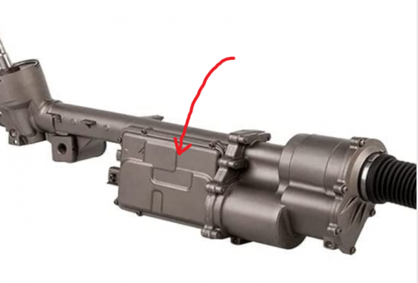

If you want "to see what's going on", remove the EPS unit from the truck HERE. Take off the pass side tie rod b/c you'll need to remove that tie rod bellow to inspect the belt. Remove the square cover door (pic below) and inspect the circuit board. Some owners have had that area partially filled with water. The board itself is encased in a plastic (conform). Inspect the circuit board if you kind of understand electronics ...for corrosion, burnt areas, and anything else. Then the belt. If you work carefully, a guy can loosen the metal bands that hold on the tie rod bellows and re-crimp the same band back on with the right tool, or even a wire knippers (the front kind).

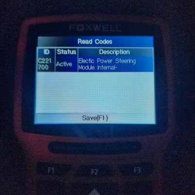

C2217-00-ELECTRIC POWER STEERING MODULE INTERNAL
Well, there we go. $2200 part it is.

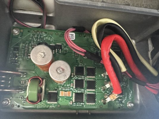

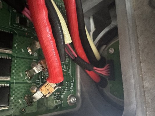

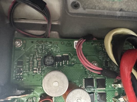

Had the exact same problem as you and fixed it a few months ago. Mine did the same thing with not throwing an error until you tried to turn the wheelIMG_1854.jpegIMG_1848.jpeg, then it’s out. I took the cover off of mine and you’ll find that there is corrosion on the actual board traces itself. I might still have pics of mine. Honestly if they just sold the board, it’d be a $20 fix. But alas I had to call around different Mopar parts vendors and somehow a dealership in Detroit had one in their backstock that they didn’t know about and I bit the bullet on it for $2k. Very easy install and I IMG_1849.jpegdidn’t need to go to the dealer. Also taking the cover off is a pain, the screws they use didn’t seem to fit any of my 5 different security torx bits I bought. Not worth it in my opinion to hassle with it. I wish you luck in locating a new one.

Had the exact same problem as you and fixed it a few months ago. Mine did the same thing with not throwing an error until you tried to turn the wheelView attachment 530394View attachment 530397, then it’s out. I took the cover off of mine and you’ll find that there is corrosion on the actual board traces itself. I might still have pics of mine. Honestly if they just sold the board, it’d be a $20 fix. But alas I had to call around different Mopar parts vendors and somehow a dealership in Detroit had one in their backstock that they didn’t know about and I bit the bullet on it for $2k. Very easy install and I View attachment 530393didn’t need to go to the dealer. Also taking the cover off is a pain, the screws they use didn’t seem to fi any of my 5 different security torx bits I bought. Not worth it in my opinion to hassle with it. I wish you luck in locating a new one.
Wow thanks for posting the pics!
Is it me, or does this not look very water tight??
