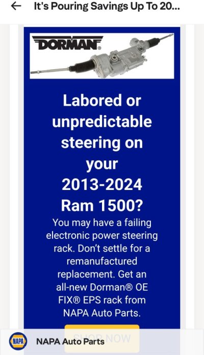

The recent Napa email advertisement shows they carry the Dorman brand. New. Good luck.
Screenshot_20260331_092730_Yahoo Mail.jpgScreenshot_20260331_094114_DuckDuckGo.jpg
