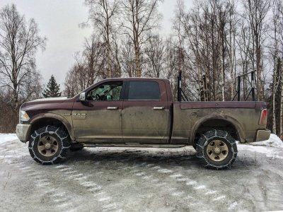

I run heavy duty square link chains front and rear on 35x12.50 tires. There will be rubbing on the radius arms and swaybar ends within 1/4 steering wheel turn of full lock.

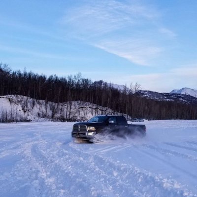

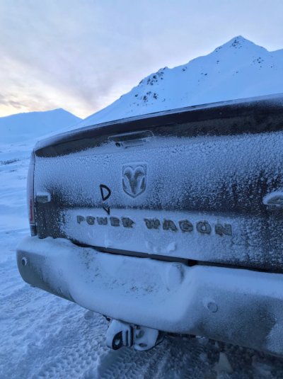

Nothing saves more time than ditching the chains for studded tires, haha.
I switched to siped and studded Hankook Dynapro MTs and didn’t put the chains on once this winter.
