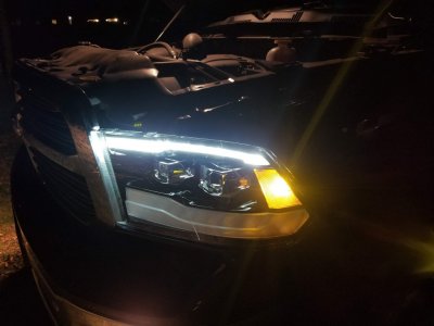

Tree line is about 50 feet away. Just got them adjusted using a #2 Phillips, very easy. Clockwise up, CC down.
I have never been able to see this far in my truck. The high beams will take a little getting used to, as their beam pattern is more similar to an Audi (big round circle).
I am getting a "Parking light out" error on my gauge cluster screen when I use the turn signals. These have an adapter to plug into the turn signal socket, but I am guessing it is still not seeing the correct resistance.
I'll likely not worry about it as the turn signals still work....I would only hear the ding and see the message when I use my signals, and I doubt it will annoy me....

Tonight I noticed, once you start truck, a message comes up, left turn signal out., but goes out right away. Then I noticed when using the left turn signal, the sound using turn signal clicks faster but is normal when looking at the turn signal outside. Doesn't bother me, just thought I would point it out.

It was difficult to get the lighting right to show through my phone. Any way it looks even better than the pictures. I love the new design.
I noticed when installing mine, on back where the DRL red wire is there's a rubber grommet but isn't as small as the wire, so is area with spraying water in certain angles, water can get in, I put a ball of butyl in hole and pressed it to seal off that small hole. Could be why the drl had moisture.

You'll probably either have to get some canbus adapters/ resistors (I think you can find opt7 one's on ebay/Amazon for ~$8) or if you have or want to get use alphaobd to set turn/park lamps to led and that should solve your problem. When I initially installed switchbacks I had set only my turn to led and every time after using the turn signals or every couple of minutes I would get a light out message. So I turned parking lamps to led and no more messages.
I read somewhere that you might have to reverse the plug to get rid of the error. I have not had any errors on mine, but they weren’t easy to get in and “click”. I was afraid Id break the wire since there is not a lot of room to grab with your fingers.

View attachment 159023 View attachment 159024 View attachment 159025
Looks good! Did you wire the DRL’s I didn’t do mine yet as I was going to remove them again. I bought a fuse tap for the power to turn on when the truck is on, but wasn’t sure where to hook up the gray wire. I think that gets hooked into the light harness to tell when the lights are on?

So far it only comes on as soon as I start truck and only says left one is out
FYI, that is just a graphic used for turn signal(s) being out. It doesn't specifically mean the left turn signal, just that a front turn signal is out (could be right or left). Same thing with the rear taillights/turn signals... the graphic always shows the passenger side light if it thinks any brake/tail is out, even if its the driver's side or the third (high mount) brake light. Its just a pretty picture, unfortunately.
