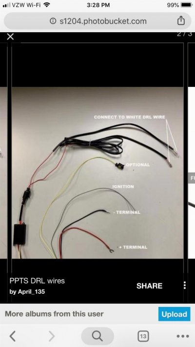

Here's what I can find for pic's off the harness and drl wires on the housing
And the back of the housing
It's weird that it appears to only be one connection for the headlights and turn/park lamps . I'd definitely like to the full harness, connection points on harness/housing if different from the pictures I found and instructions.

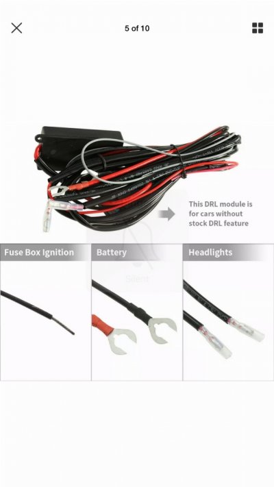

Edit : pulled this from Amazon in the questions modifystreet had a link
Yeah, the pics definitely leave a lot of questions. That DRL harness seems to have an awful lot of connections to get an led to run at all times on fused accessory power. You’d think there would be two 3-way plugs coming out of the housing- one for highs and lows, and one for turns and parking. Hopefully that one red wire is all that is needed to enable factory dedicated DRL. I’ll probably end up buying them just cuz they’re cheap and out of sheer boredom, but I’m curious so I know how to configure my harness. My truck came with quads, but I installed the entire front end harness from a factory projector truck, added the missing wires from the BCM, and configured the BCM as if it came factory with projectors. So, I plan on whipping up some “reverse” adapter harnesses to go back to the quad plugs, while retaining the dedicated DRL circuit.
From what I've read in the questions if you have factory drl's you don't need the drl harness. I'm definitely curious on why their is only on connection. I'm real close to pulling the trigger on these and modifying them. Swapping the turn signals to switchbacks and upgrading the drl led.
Edit: another thing I noticed is the one connector is a very cheap one. It's the same one that retroshop used on the v1 projector adapters and the pins would always twist and didn't have a tight connection. I'd definitely swap it out for the one's mouser sells.

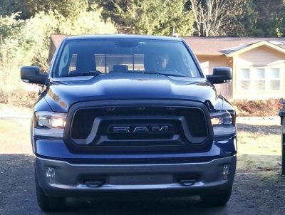

I actually bought the 2018 style a few weeks ago and got them installed this past week. I love them. The light output is as good as OEM projectors. Adjustment is easy except make sure you adjust them when installing cause you have to pull them back off to adjust them. The DRL module that they include you can use but I personally didn’t. If you have Alfa you can enable turn signal DRLs. They will light up amber. When the lights are turned on they light up white. I’ll post some pictures tonight of the light output and what they look like when they are on and running. I have LEDs in my low beam with out error decoders on them and they don’t flash at all. For the DRL with their equipped module they only hook up to the turn signal light. If you buy a fuse tap it’s an easy install. When the DRLs are on they light up white where the turn signal is.

The DRL driver wire never crossed my mind. I have a truck with factory quads....should I plan on running the missing BCM wire? Or per @Lawsuit11's post, do I just rely on the turn signals to act like switchbacks?
As far as trying them out, they are coming from Amazon of all places, so returning them for refund should be a pretty easy task if it comes down to it.
I believe Lawsuit11’s are the factory projector style as opposed to the ones with the DRLs on top. On the 2019 style, you would have to use the dedicated DRL circuit if you were going to activate them alfa. Since you have the big horn, the dedicated DRLs should be wired from the bcm to the front end connector already. I would definitely use that circuit if possible because I despise tapping factory wiring and fuses.

Thanks.. Did not know big horns have the DRL lead already. Would definitely extend it to the headlight instead of using their adapter.

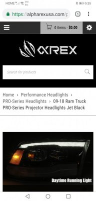

Not sure what I'm Doing(lighting noob) I just know I enabled drl in bulldog and now headlights come on in day. Also under lights on alpharexusa look at this one part I screenshot, about light show etc on pro series. I didn't take my lights apart since I used the h7 halogens it came with. Turn signal there are wires connected to a plug like the OEM light on our turns, plug that into the OEM socket instead of a bulb, put socket in light and plug harness in.
Alpha is alphaobd which is a android app paired with a obd2 reader that allows you to add factory features such as drl's and choose where you want them, like parking lights, low or high beams or fogs. I think their description of the term switchbacks is misleading. I appears that the drl drops out when the signal light is active and returns when off. The other set they are referring to is $1200.
It looks like the bully dog can only enable the high beams at reduced power as DRLs. Those alpharex lights look similar to the modifystreet ones, but has more features, like sequential turns and light show. Like 1500ram12 said, the AlfaOBD can enable DRLs in different locations, although parking lights isn’t one of them. Since the upper white led also functions as the parking lights, the only location that can be set by the alfaobd is the dedicated DRL circuit, which requires bringing those wires from the bcm to the lights. Or, using the supplied DRL harness which I assume would have them on any time the truck is on. The alfaobd also has the ability to add a DRL on/off setting to the radio settings so you can shut them down whenever you want.
Were you saying that alphaobd couldn't set drl's to the parking lights or couldn't be set on those lights? I believe that the alpharex lights maybe the same as the modifystreet one's. All the photos are the same between the two companies

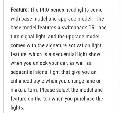

Alfa is not able to set the parking lights to be DRLs. It can set the turn signals as DRLs, but since the upper white light is detached from the turn signal circuit, the only other way is to set them as dedicated.
The only difference I’m reading about the alpharex lights is the sequential turn signals and the light show. Like you said, they are not actual switchbacks, but rather the parking light drops out when the turn signal is used.
I was thinking that the parking light was what alphaobd was technically enabling as the drl not the turn signal. I used that for a while until I installed switchbacks and didn't like that you couldn't really see the white when it's was on so switched to highs for now.
So I wonder if the $330 version is more like the modifystreet one's and the $340 is the "upgraded" version with the sequential light feature
