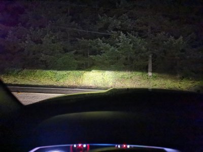

Can you let me know how to adjust the light, I see a wheel in area the normal adjustment screw is on oem but not sure how to turn it when installed in truck, not even sure if it can be. My beam on the h7 standard bulbs is off and need it adjusted.
So this is with just regular halogen bulbs not HIDs?
rotwiler
rotwiler
Oct 20, 2017
1,019
517
Washington
Yes, just the regular h7 they come with, here are more photos of the cutoff line etc. The phone does make them look a little brighter than in real life, but they still put out a nice amount of light. Before this I had quad lights with the 65 watt bulb upgrade(where you modify base) and these for sure are better on road. They do have a little yellow like most oem, I would still like to put like 6000k bulbs, I like the pure white look.
