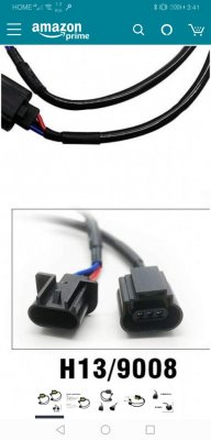

Anyone know, if i buy a anti flicker module and find one that can match up to this wire harness, will I be ok using it outside the lights in line, since I will only possibly get low beams, would the antiflicker mess with the halogen in high beams. Also does anyone know what this connector is. Like is it a 9008 or? I seen some pre wired with connectors, would be nice to just plug in.
View attachment 159994 pre wired ones I seen that look about right.
The connector on the back of the headlight housing don’t relate to bulbs themselves. It’s just the 3-way connector that ram has chosen to deliver the high, low, turn, and park light circuits into the housing. From there they branch of the their respective bulb connectors. The 9008/h13 bulb handles both high and low beam, hence the reason it has three wires. It may just be a coincidence that they happen to look similar to the connectors ram chose to use on their quad housings to truck harness, and I’m not sure if they’re the same or not. Since this housing takes h7 bulbs, you would be looking for an in-line anti-flicker module that has the h7 female connector on one end and the male connector on the other end. The bulb connector is inside the housing, so that’s where any add on harness is going to originate, and depending on how much room is inside the housing, may have to be brought outside the housing depending on it’s size. Most lights, whether hid or led, offer the option to add it’s specific anti flicker module as an add-on item.Anyone know, if i buy a anti flicker module and find one that can match up to this wire harness, will I be ok using it outside the lights in line, since I will only possibly get low beams, would the antiflicker mess with the halogen in high beams. Also does anyone know what this connector is. Like is it a 9008 or? I seen some pre wired with connectors, would be nice to just plug in.
