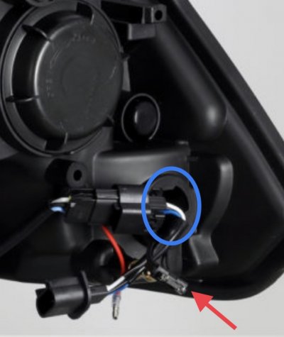

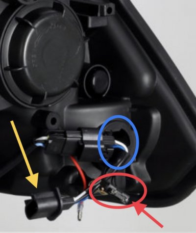

@rotwiler, can you explain to us what’s going on with this connector (red arrow), and this hole (circled in blue)? PJYpoEz.jpg
I can’t remember exactly how the factory quad headlights are arranged with the two connectors. I’m guessing that you remove the factory parking light bulb from the base, plug the connector that the red arrow is pointing to into the base, clock the base into the hole that is circled in blue, and plug the truck harness connector into the bulb base connector, correct? I just want to make sure, since now I have projectors, I don’t have that bulb base anymore, and I need to know what to order for my conversion harness.
Quad factory set up has two connectors that are similar. H13 looking. One for parking/turn and one for lows/highs. It looks like the one actual connector on these headlights is for park/turn and the one in question is for the headlights and drl's. But I have no idea how those connect to the truck unless there is something on the drl harness that comes with the headlights
From what I understand the hole is for use if you have factory enabled drl's. I'm guessing there is a connection on that harness the goes into the headlights and connects to the drl.
I’m kinda thinking (hoping) it’s the opposite. Since I can’t find my original quad truck harness, I’m just going off of faint memory- one of the connector harness length is shorter than the other, and, if I remember, the shorter length connector is the one for lows/highs. The parking light bulb for the quads is a 3157 (both park and turn). That hole that I have circled in blue *kinda* looks like it’s keyed for a 3157 bulb socket. I can’t remember, but can you confirm for me if the entire parking light bulb socket can be removed directly from the back of the quad headlight housing? If so, that will confirm what I’m thinking that the parking light bulb gets removed from the socket, and that connector that I have the red arrow pointing to gets plugged into the bulb socket. Then, the connector that the yellow arrow is pointing to gets plugged into the high beam/low beam truck connector. q5bLPKQ.jpg
It sucks trying to figure this out for harness parts without having neither the quad headlights or the new headlights in hand!
The harness(closest to the outside of truck) is the park/turn and the other is the low/high. (Can't remember off hand which is longer) Yes the bulb socket for the park/turn can be unplugged from the harness and removed from the headlight housing, it's a 3157.
Sounds good. I’ll have to order a pair of 3157 socket pigtails since I don’t have the quads to take them out of.

Think that black wire in photo is one that plugs into your socket for turn signal(where bulb used to be) , then screws into hole like the normal turn signal bulb on the lights. Only a red wire was coming out of the back as far as I can remember.

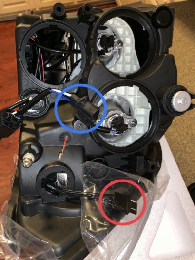

There’s 2” clearance from the low beam bulb base to back of cover, and 3” clearance for the high beam. There’s no way that ANY hid ballast will fit inside.
Pretty simple- blue circled connector gets plugged into the high/low/ground truck connector. Red circled connector gets plugged into the parking bulb socket (which gets removed from the quad housing and installed into the hole on these lights). Red wire is for DRLs, and since I had the projector harness, I plugged it into the dedicated DRL wire. I ordered mine straight from alpharex and these did NOT come with the DRL harness. Not that I care, as I wasn’t gonna use it anyway, but I’m pretty sure it’s just a regular relay- battery positive, ground, and trigger (whatever you want to use that will be hot when you want the DRLs on). From what others have posted about the turn signals and from what I just tested, these things need resistors for the parking lights and turn signals. When the lights are not on, the turn signals have a hard time keeping rhythm, and eventually they’ll give up and throw the turn signal out warning (probably because of the PWM). Next key cycle, they’ll be fine again, then it’ll start all over. When the lights are on and you hit the turn signal, because the white parking light drops out for the signal, the truck throws a parking light out error. This was all corrected by using the alfa to enable LED turns and parking lights, but for those that don’t have the alfa, plan on using resistors. For those that currently have projectors and want these, making the harness is simple and cheap, and no resistors will be needed because projector trucks are already set up for led turns and parking lights. I’ll make a how to post with a drawing and part numbers for the harness in a bit.
I’ll be opening these up this weekend to do some painting and turn signal switchbacks, so for those that are wondering, it looks like the same type of sealant as factory projectors, and it’s got the same channels and clips. WpIC4SU.jpg
One other thing I noticed, the low beam shutter is fixed, so it doesn’t drop when the high beams are on.
