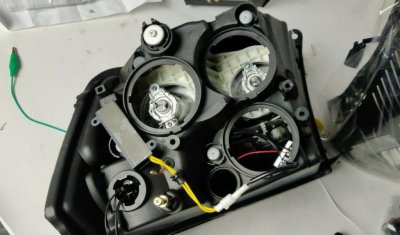

Ok, guys and gals...reaching out again because I’m close to giving up. I can’t get rid of the B16BF Parking Light Out error. Closest I’ve got is only getting it when lights or parking lights are on and I use directional. I tried changing settings to the suggestions by @1500ram12 but it did not work. I’ve contacted AlphaRex and he is suggesting I try disconnecting the load resistor if simple Alfa LED Park/marker and LED turn signals changes didn’t work. Thoughts? Reaching out to @koblesCar and @SitKneelBend because I know they are both running G2s.

Do you currently have resistors in?

I would try disconnecting that and see what happens.
2018 Ram 2500 6.4L Hemi Tradesman
Ok. I hate pulling everything apart, but it’s worth a try.
Side note, in case this is any help. I’m still playing with settings as I post. I’ve returned all the settings to factory. If I have just the LED turn lamps setting on, I only get error code when lights are on and I use directional. As soon as directional goes off, error goes away. If I have LED turn lamps and LED park/marker lamps on, I get error as soon as I turn headlights on and the error stays until I turn off headlights.

I know it's a pain. I've gotten to the point where it takes me about a minute to get them out.
Do you have VehConfig 3 high intensity discharge lights enabled?
Try turning led turns off and parking on and see what happens
Then increase the voltage on the turn/park up to 12.2v

No on the HID. I changed that back and the voltages back. But I was wondering...do you think I should maybe change the voltage to the rear lights? I tried putting them to 12.2 and it made it worse. Should I try going back to your previous suggestions and maybe doing rears to 14? The are stock at 13
BTW - I greatly appreciate your advice and help. This is super frustrating on my side but at least I have solid advice coming.

Try turning hid back on after removing the resistors. A theory is that these lights may use more power than the halogens and the increased voltage to the turn/parks works like a resistor. I was having the same issue as you. When the headlights were on I'd get a turn signal out message. I installed resistors for a while while chrisbh17 and I tossed ideas around. What worked for me was what I posted. I also think that once the resistors are out and use the settings I posted you should be good. If not we'll figure what works for your truck. Another though was having high and/or low's set to led also effects the turn/park lights in a negative way

At one point, I had all LED features turned on and that is when I couldn’t pinpoint the problem. It was all over the place, retiring randomly
Reading this thread, it sounds like there are a lot of configs used bc the trucks all respond differently.

It's weird but it does seem that every truck responds differently to upgrades
