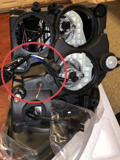

For those that have factory projectors that want these, here’s an easy conversion harness you can make. The headlights already come with one third of the parts- this little extension harness (circled)- kmBXyK7.jpg

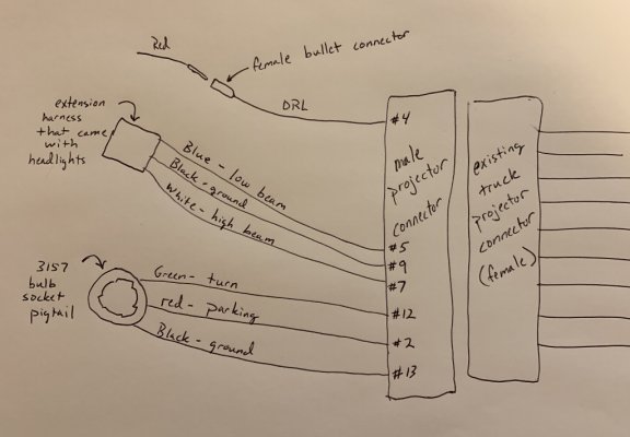

Here’s the 3157 bulb socket pigtails that goes into the socket holes on the new lights- https://www.amazon.com/iJDMTOY-Pre-...ghts&qid=1553571390&s=gateway&sr=8-1-fkmrnull
And here’s the male projector harness mating connector (2 sets)(thanks for the link @1500ram12)- https://www.amazon.com/headlights-1J0973837-lamp-socket-Headlight-connector/dp/B07LD6C2R1?th=1&psc=1
And you’ll need two 10” lengths of 18awg wire with two female bullet connectors for the DRL wire (not sure what size, I had some red ones laying around that fit).
Then just crimp the appropriate male projector connector terminals on the ends of the wires (pay attention because some wires get small terminals and some get the large terminals), and insert them into the correct numbered pin positions. g840zqD.jpg
Note: in order for the DRLs to function with this wiring method, the dedicated DRLs need to be enabled with the alfaobd. Otherwise, don’t pin the red wire into the projector connector, and use a relay harness to trigger them.
Here’s the 3157 bulb socket pigtails that goes into the socket holes on the new lights- https://www.amazon.com/iJDMTOY-Pre-Wired-Harness-Repair-Replacement/dp/B01GP6B9WA/ref=mp_s_a_1_fkmrnull_1?keywords=iJDMTOY+(2)+3156+3157+Pre-Wired+Harness+Sockets+For+Repair,+Replacement,+Install+LED+Bulbs+For+Turn+Signal+Lights,+DRL+Lamps+or+Brake/Tail+Lights&qid=1553571390&s=gateway&sr=8-1-fkmrnull
Jimmy07 - Can you send a finished picture of this harness? I would love to copy this but wanted to see it before ordering everything. Thank you
Jimmy07
Feb 23, 2017
3,507
3,548
I don’t have the finished harness yet because the male projector connector kit is coming straight from China. I improvised for right now by bypassing the the truck connector and tapped straight into the proper wires, then when I have everything, I’ll redo the connector.
