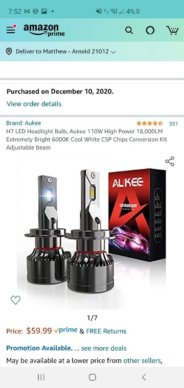

I'll try one more led bulb.... they arrive Friday.
Reviews seem good. Some say better then ultras
I'll put one of each in my lows and see how they look.
Sent from my SM-G975U1 using Tapatalk

I'd run those a few minutes before buttoning up the job, 110w might get your wiring!
