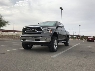

I’m running 35s but in a Nitto ridge grappler but I’m also lifted. I love this tire Sorry these are the only pics I have of the tires not really any close ups

Yes my truck is leveled so I wonder if these would rub on a full lock

It looks like yours is leveled. What size tires and wheels do you have? No rubbing issues

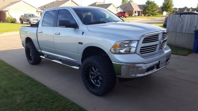

If I was looking for a great all terrain tire, I would go with the Nitto ridge grappler. Nitto is known for getting 60,000+ miles out of their tires, and they look cool as hell.
Graygoose, how wide are your wheels? 12"?
12.50
Just drove 120 miles...love them
