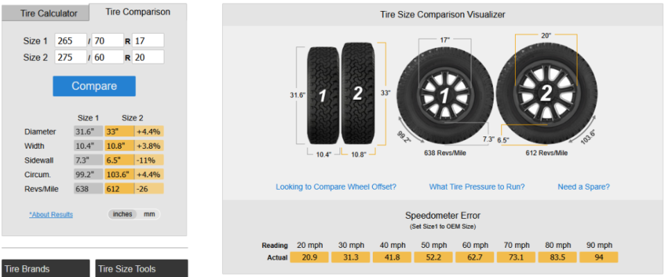

I just went from 285/70R17 (32.7" diameter) to 275/65R20 (34.1" diameter) -
It takes about 90 seconds to recalibrate the speedometer using JSCAN.. worth doing not only for the accuracy of the speedo itself but also for transmission shift behavior and throttle behavior since those are also based on road speed, engine load and commanded throttle position. You'll save the price of a JSCAN license in fuel before summer.
In my case going from 32.7 to 34.1 is about a 4.3% difference which is almost identical to the 4.4% difference you'll see going from 31.6" to 33".
