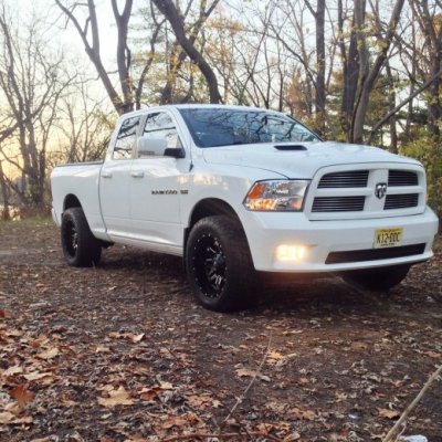

hey guys im runin a 2 1/2" hbs level kit in the front and have 305/55r/20 terra grapplers right now.i need new tires and want to go bigger i was thinkin 35x1250R20 (34.5).what do you think and what are you guys runin.pics would be a big help to.thanks

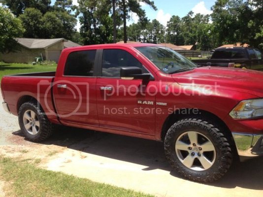

i run a 295/65/20 trail grappler(35x12) on stock rims with just a level kit

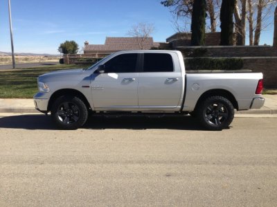

I'm running 285/65r20 bfg ko2's and bilsteins maxed.

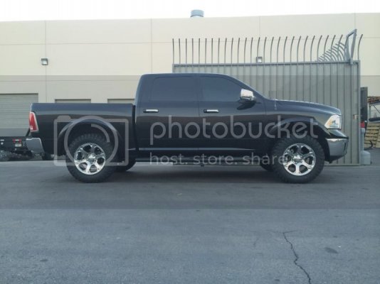

I have a Maxtrac 2.5" level and run 35x12.5's on stock wheels, no trimming or spacers needed and I don't rub at all even at full lock

Thanks,truck looks good.im going with the 35x12.5' federal couragia M/T hopefully have them next week il post a pic when there on
