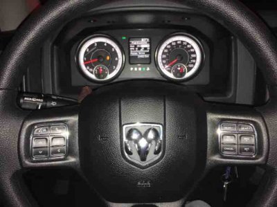

Conveniently I have the vr and call buttons. Just no audio controls. And mic is next to the visor. It would be nice if it will work. I don't need anything to fancy like the 8.4. Hoping to snag a uconnect 5.0 when someone upgrades to the 8.4

Can you post a picture of your radio? Sounds like you have the new for 2017 uConnect 3.0.

Thanks. Do you know what the sales code is for your uConnect 3.0 radio, ie RA1, RA2, etc?
If you do swap to a uConnect 5.0, it should be a direct swap.
Also please let me know the PN of the 5.0 radio you get, especially if it's from a 2017 truck because I'm tracking the PNs in my thread ...
