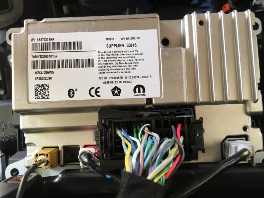

Says uconnect 3.0 with integrated voice and Bluetooth. I don't see anything else except vp1 radio. IMG_1605.JPGIMG_1606.JPG
Sounds like it's probably a RA1/Vp1-NA radio but with the new 2017 BT/VR features.
And chance you can send a request to FCA for your build sheet. You should get the detailed one that lists the actual sales codes also..
send an email with your VIN# to: [email protected]
They answered me with my detailed build sheet in 1 day.
Here's a sample of mine ...
Here's my build sheet with notable "common" upgrade related items highlighted...

Alright so finally got the build sheet. Re emailed ram. Radio is classified as a UA1 Uconnect 3.0

UA1 Uconnect 3.0
