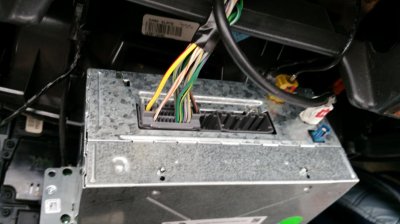

Just an update for anybody who cares. The radio was plug and play (wires and fitment), thank goodness because a new bezel is like $180+. The radio works great, sat radio works, and everything. HDD is only 16gb.
I still need to add the GPS antenna. I wasn't sure if it would use the other antenna or not. Looks like it needs it's own. Also I'll need a mic to use the hands free calling. I know there is a mirror with mic built in, but I may just add the standalone mic which saves a ton of money.
Mic kit with wire was 30 and gps antenna 16 shipped, so my total is right at 366 with everything including shipping.
Last thing will be a backup camera, but I may not do that. I don't know.

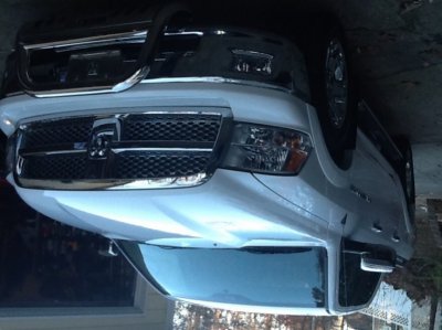

I don't post a lot on forums but this is first time my pictures are upside down...darn. Anybody know how to fix. I tries rotating picture with hope it would put it upright...no love. Every time I touch insert picture I loose everything
