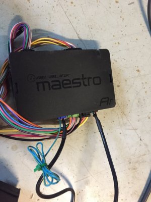

WIth the maestro harness, I am fairly certain you will retain the factory camera. It has a yellow video rca on the harness for that reason.
I did not have a factory cam on my old truck so I didn’t use this plug on the harness, but added an aftermarket and damn new wires.

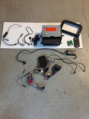

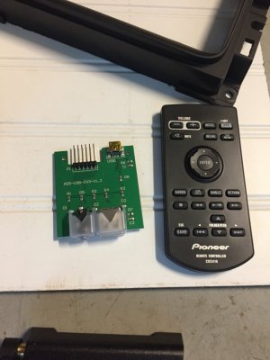

Here is a for sale pic of what I had. (Again, already sold these, just a visual reference)
Maestro unit
New usb chip for center console
Antenna adaptor and XM adaptor (I think)
And everything. Dash kit, etc.
You can actually see the yellow rca in the lower harness sticking out.
The auto headlight and everything will not be effected. My Express didn’t have a lot of these features but I do know that whatever you adjust on the stock radio will be retained when the new is installed. Not sure if the adjustability will be there but it will not delete the options if that makes sense.
