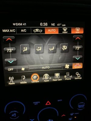

427B1683-AD4F-4E9E-978A-DE1199AC0A6B.jpeg FB7D8388-EC35-48B6-8807-DE7D3455CE71.jpeg Got after it this morning with the AlfaOBD tool. Flashed it to dual arc and everything is working as expected - temp, fan speed, and vents all adjusting properly for a single zone. The flash for single zone ATC failed, so will have to sort that out later today. I may be out of sequence or not have waited long enough.

View attachment 154486 View attachment 154487 Got after it this morning with the AlfaOBD tool. Flashed it to dual arc and everything is working as expected - temp, fan speed, and vents all adjusting properly for a single zone. The flash for single zone ATC failed, so will have to sort that out later today. I may be out of sequence or not have waited long enough.
I reccomend flashing it back to single zone MTC and waiting until your sure it completely takes. And then start the sequence again. Flash the dual zone ATC and verify it takes. I Recommend I one waiting through several ignition on off cycles before activating the single zone ATC. I personally don't turn the system on or adjust any of the features when it's on dual zone because I don't want to get any DTC codes. After you set the single zone ATC give it plenty of time to take as well. I haven't used the windows version of the tool so I can't comment on whether or not it works as well as the android version but I am assuming it should. Just make sure you give it plenty of time between settings. Good luck let us know how it goes.

Success! Drove it to work and back then reattempted the single zone ATC after shutting down. It worked perfectly and all functions appear to be intact. Thanks for the guidance and saving me some money and heartache with the dealer route
