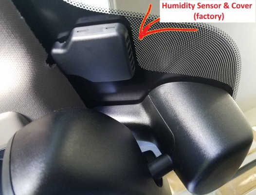

When setting auto climate contol to a specific temperature--it works great--fan speed probably 4 or so---question is after the climate control reackes set or desired temp-should the fan speed slow down--semms like mine will not and sometimes gets what seems like a little too cool---thanks
There is a lot of things to factory. First off do you have a 1500 or 2500+. If it’s a 1500 where is you’re humidity sensor at. This could cause problems if it’s not detecting the humidity correctly. Constantly running to lower the humidity in your truck.

It is a Laramie 1500 crew cab---where would humidity sensor be---have run it a night and no fan slow down but only 25 miles or so--if I raise the temp manually it will slow down but doesn't that defeat the purpose of Auto climate control

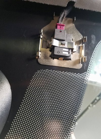

Mpgrimm2
Supporting Vendor Navy Badge
Mar 30, 2014
6,569
5,155
SC
2022 Ram 1500 (5th Gen)
5.7L
I set mine at 70-71° and it always seems to work great...after the cabin reaches a good temp the fan speed definitely slows down and just maintains everything.
This is how my 18 Laramie 1500 with factory dual zone ATC behaves also. PN below if you need it...
@reborn55 , I would change the cabin Temp Sensor first. (below ignition sw)
- Humidity Sensor (2014-2018 1500's w/ATC): 55111389AF.
- Cabin Air Temp Sensor (13-18's ALL w/ATC):
55111178AC.
