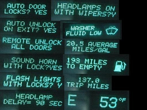

Then you don't have an EVIC, you have an OTIS. EVIC menu looks like this, note the first one on the left:

That's not in the dash, dash EVIC wasn't available in the 3rd gen. This is the module in the overhead console.
OTIS = Overhead Travel Information System
