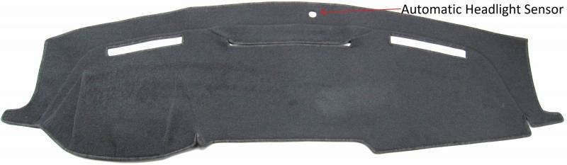

2015 Ram1500
This is where the sensor is located to run the lights.
