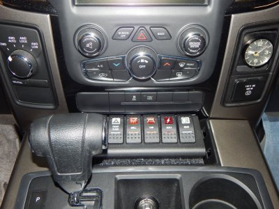

If you want something that is "plug & play", and extremely easy to wire up, look at Spod, not cheap, but a quality product. You could also go with the factory style in dash switches. This is how I have my Spod installed,
4x4 sPOD |
www.4x4spod.com
sPOD is a family-owned company dedicated to creating precision power distribution systems for off-road vehicles, agricultural equipment, utility vehicles, race .
