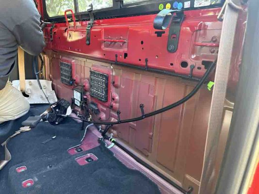

My dealership ordered the window backlite set and had delivered to dealership. Dealership contracted with 3rd party and they came here and replaced the rear window assembly in my driveway.
