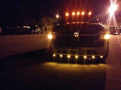

Loved the write-up on this mod so much I did mine! However, the four 3mm amber LED's I got from lighthouseleds.com weren't as bright as advertised/I thought they'd be.....
Seriously thinking about getting another grill emblem and redo the mod with brighter LED's...after some researching other LED options...20190223_201520.jpg 20190223_201551.jpg taken at work parking lot....

Looking at my post from last Saturday...the pics I took with my K30 smartphone makes my grill emblem look brighter than it is seeing it with your eye.
Still researching LED options as well as another emblem.

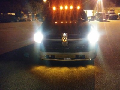

Finished my redo with better LED's.
Much better result the second time around!
