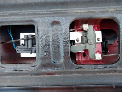

If you you're really feeling ambitious, there is a remote power tailgate lock from https://paceedwardsdirect.com/p/pace-edwards-powergate-tailgate-lock/pei-lk160/ that bolts right in place inside the gate and ties into the RKE:
If you aren't feeling that ambitious, Pace Edwards has an optional small key manual lock handle available.
