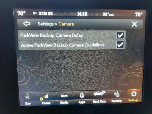

The backup camera guidelines on my 2019 Ram Longhorn have disappeared. Try as I may, I cannot find a way to reset them. Any help would be appreciated

Have you verified the enable grid lines option is checked in settings on the Uconnect radio?
I'm looking to see if I have a picture on my PC before I go to my truck to find the location. :cool:

Thanx. The manual had been no help, but after your post and pic, I found it on the screen in about 15 seconds. Don't know how I kept missing it.
You're welcome, glad to hear you have it sorted out.
There are many options in the settings screens, and sometimes the one we want hides from us. :cool:
