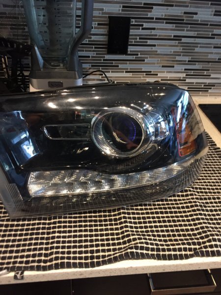

http://www.ramforum.com/picture.php?albumid=3474&pictureid=22660
The first headlights i did, i blacked out the DRL. I wasnt a fan. I found the light output was'nt great and the tint didnt go on well.
I traded the headlight on kijiji for a factory set...worked out well for both of us.

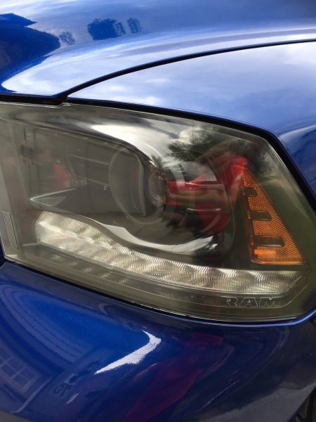

http://www.ramforum.com/picture.php?albumid=3474&pictureid=22661
http://www.ramforum.com/picture.php?albumid=3474&pictureid=22662
The second set, i just blackout out the bezel. Really happy with the results. no condensation on either.

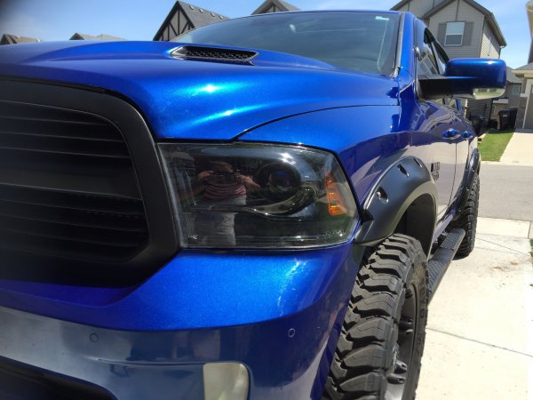

http://www.ramforum.com/picture.php?albumid=3473&pictureid=22655

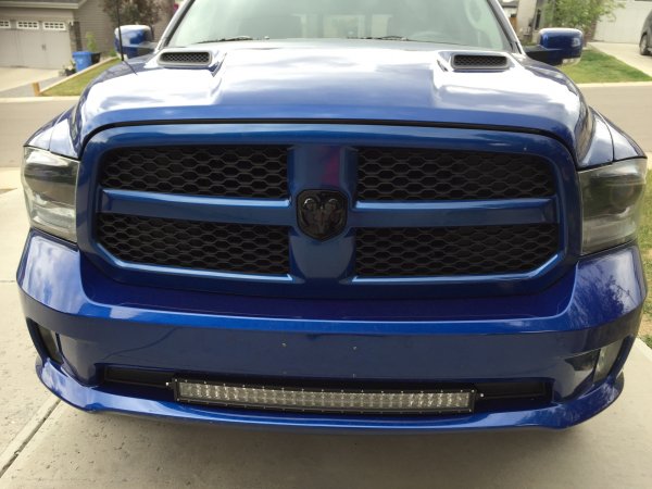

http://www.ramforum.com/picture.php?albumid=3473&pictureid=22653
Crappy picture, with the daylight but gives you an idea.
