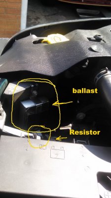

Heres mine...My ballast are bolted on since they're a little heavier and the canbus relay being lighter is zip tied to the side of the fuse box...basically the same on the other side...remember they should have air flow because they do get hot
