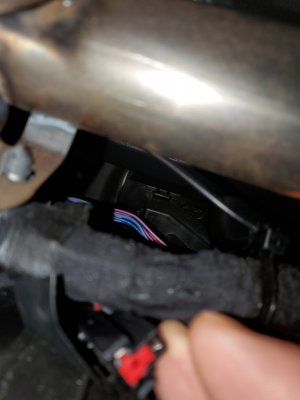

Since new in 2015 my ram sport crew has had a light banging under dash on passenger side. It has become worse over time than again so has the roads so that's probably why louder now lol. Anyways I have both glove boxes out and need to take the wife on a ride to see if she can find it on a real bumpy road. I've looked felt and tugged around and nothing stands out. Ive padded a few wires still bangs. It must be under dash above hvac is all I can think of and what a big job it looks like to take that one whole piece off yikes. I think I saw a video on how to do this but it was from a 3rd gen ram I think. I did notice one wire tapped up on left side. It almost looks like maybe it was for a light in lower glove box? I have a light in top but not sure what this 3 prong plug would have been for. Any real ideas of it's possible use? Anyways if I find what the banging is I'll let you a know incase you have same or similar problem. Unless someone here has already had this and knows so I know more on what to look for. Thank you all as so many great people on this board.
Btw I'm so interested in that trx if and when it debuts price and available lol. What a beast it woud be to own I bet lol. Especially to take out those kids in their pocket rocket fart can exhaust cars. Take care all be safe stay well.
I've uploaded a pic of this mysterious wire

Have your wife try and put pressure on the windshield while driving to see if the bump stops. I've heard this has been the issue in the past...
