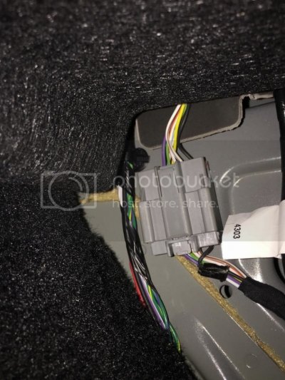

Sorry to bring this back to the top. I am about to tap into the front speakers but want to make sure this right. This is a connector at the front passenger side panel.
Can I tap right above that adapter into the yellow/green and pink/purple wires? Or is there a better place?

Well I hooked everything up and the Hideaway won't even power up. I am at a loss. I checked the voltage at the harness and it is getting power so I am guessing it is the remote turn on. I also checked fuses and they were fine.
Any ideas? Here is a picture of where I tapped into the RF +/- under the passenger side kick panel.
P
Paradeedle
Jan 26, 2015
81
20
I got it figured out. Apparently the white wire is the only one that the remote turn on works for. Swapped out the grey wires for the white wires and it came on. Just need to tune it now.
