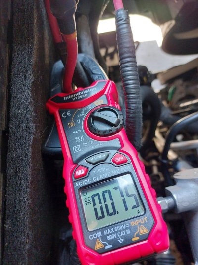

I fully charged the battery I pulled the WW 30a fuse and have had zero battery drain. I am going to put the fuse back in, let the truck sit for a few days and see what happens.
I don't have much patience for waiting or playing guessing games while troubleshooting electrical gremlins. :cool:
These things are pretty cheap on Amazon.
