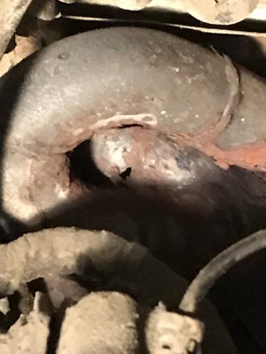

Here’s a picture of my headers I installed 16 months ago.
Chrome plated BBK shorties
Tried contacting bbk directly 2 days ago still no response.
crackerjack1957
Sep 26, 2015
2,380
3,318
2014 Sport 1500 CC 4x4
Hemi 5.7...65RFE...4.56
Looks like ****, probably rusted from inside out if only chromed on outside......doesn't say much for BBK

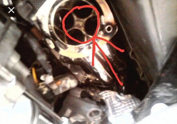

Brandon-w
Jan 2, 2019
3,649
6,112
Yukon
2015 Ram 1500
Do you find where the headers are leaking ? Is it the both sides like me ? I didn't find a single trace of leakage like black marks from the exhaust gas
They leak here.(SEE PIC)
If you stick ur hose in where they all. Collect together and put your ear to it while Running you should hear the ticking/muffled noise. fb902c3081e981e660f80de89d012ede.jpg

Doodoo972
Mar 1, 2019
165
101
Martinique
Ok thanks for the pics. It's surely the same thing on mine. It's very irritating...
Yours are leaking on the both sides?
