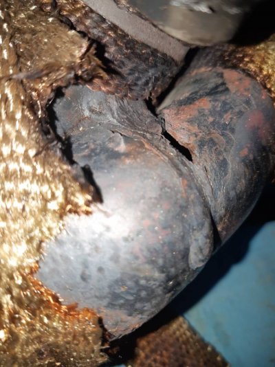

Another reminder to not go with bbk. Took my headers off today because of ticking, 9 months old.... Real impressed. 5215ba1e9140be156ca4add84f9501d8.jpg

Is that header wrap on them?
Header wrap is a guaranteed way to make headers rust out. Usually will void any header warranty also.
I put some header wrap on my JBA ceramic coated stainless headers on my old 5.9, just in a few spots.
The only place that there was any rust on those headers when I took them off was where the wrap was installed - the rest of the header looked perfect.

Wow that's bad[emoji15]
That doesn't even look like 409 stainless, just raw steel....

Spend the extra to get the stainless ceramic coated version, the mild steel with plating is not holding up to the elements. For the $250 I spent it Was worth the attempt with proper wrapping and silicone coating to seal, we’ll see how long they last. The issue with wrapping alone is it holds moisture.

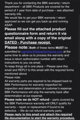

Has anyone had BBK uphold a warranty?
Mine failed in 2 spots primary to collector merge. Emailed tech and warranty without response yet. I would consider trying their ceramic and pay the difference but I won’t hold my breath.

BBK told me to go pound sand with an automated response. Sure, I’d love to carefully send them back for you to review and wait like I have nothing better to do with my time.
F-that, I’m cutting the primaries at the flange if the stock logs are going back in.

No refunds, like I want to waste more time with your garbage.
I’ll pull the y pipe back and see if I can put a bead on to nurse it til I can put long tubes on.
