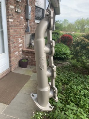

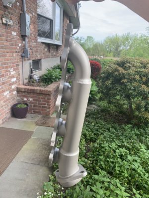

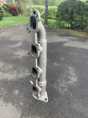

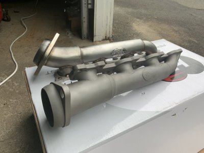

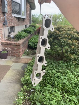

Man those BBKs look like poo and they don’t look fun to install. I would coat anything you put on the exhaust and it has to be ceramic coating and not powder coat. Chrome is not an exhaust coating and it’s not even a good rust preventative coating.
I just got a set of ****** black hearts, look super easy to install and they are 409SS which I’m not thrilled about but it’s better than mild steel. Best part is they don’t need any mods to the valve cover or heat shields and all the bolts are super accessible. I just blasted and coated them 2 days ago with creakote ceramic coating inside and out. Stuff is cheap and it’s an air cure version so u just let it dry for 24hrs and install (full cure 5 days). Good for 2000+*F and stuff is stupid strong and should let these 409SS headers last a Long time of the coating doesn’t get damaged. I have used this stuff on turbos and turbo systems which generate the hottest exhaust temps and it still looks great!
So it’s another option for you guys, headers are like $450 and only come bare I think. The coating is $35 for 4 oz which I could easily do 2 sets as i used about .75oz each header to coat inside and outside. I also picked up some ARP 304SS header bolts for the ram so hopefully no broken bolts as they are stronger than the stockers. Once u coat them you don’t need to wrap them and it retains heat and keeps them from rusting.

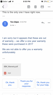

Here you go. I got what I paid for I guess. Going back stock for me I guess because there’s no way I’m paying 2g for an exhaust header!
That sucks. Or you could spend $500 for any of the 409 SS headers. You put the stock manifolds back on and ur more than likely going to pop a bolt, get a leak and then have to pay or get out the broken bolt yourself (or multiple bolts). Up to you.

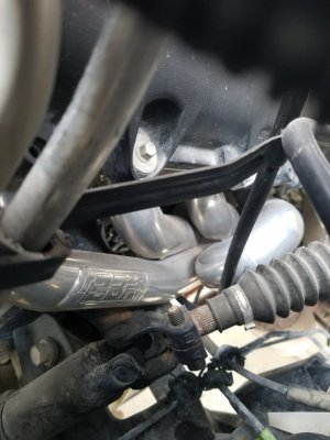

wow bro thats nut, here are my bbk ceramic shorty on ram hemi. been 2yrs and look new
bbk rep took care of me w install questions and returning chrome for ceramic. glad i got ceramic

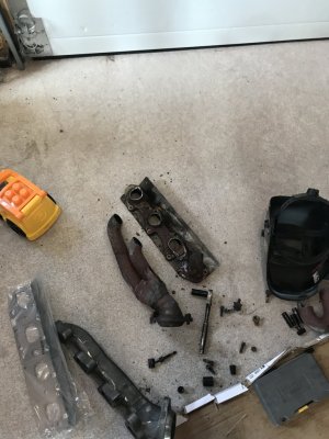

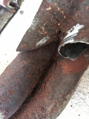

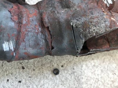

So here’s the drivers side header. I’m replacing with stock. There was two holes in the bbk shorty. Both on the same port. The rest of the header seemed in good shape. Again..installed 16 months ago or so I installed them.
In order to remove the headed with access to the bolts I had to use a recip saw to cut it apart.

Did you have fender liners on?
Can’t believe those corroded that bad/quickly. Great idea on the sawsall, they’re trash so just make your life easier.

Liners were in for driving yes , removed them to get at the exhaust tho lol
