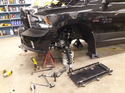

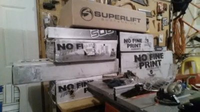

The party is starting now! BDS 4" lift kit, BDS braided brake lines, Spohn adjustable track bar and Superlift rear coils.

Starting day number two. So far everything has gone smoothly. I recommend having a thread chaser for the differential 12mm mounting bolts to clean out the OE red loctite.

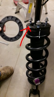

Quick question about step #54 for preload spacer installation.
So I pull the top mounting plate off the strut and add the preload spacer, I then turn the top mounting bracket 180 degrees(red arrow) and reassemble the strut?
I don't think you even need the preload spacer on 4". #46 on Zone instructions states "skip to #49, the preload is not required" on the 4inch. It is only used if not running Bils on the 6".
