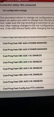

Here you go
Custsetmenu Auxilary Switch CSM= enabled (adds it to the EVIC) everything below can be done in the EVIC or Alfa. In the EVIC you will have to set a PIN number before you can get to the settings.
You will have Cust Prog Feat CBC Aux type= momentary or latching
Cust prog feat CBC Aux Power Managed = ign or bat
Cust prog feat CBC Aux HL = enabled/disabled (this is to hold the last power state)
D0DB05A6-6B46-4052-8B7B-002626EF0505.jpeg C0F3BB72-C055-414F-9815-BD40ED62ED6D.jpeg
