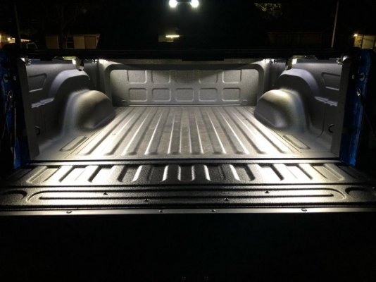

I have the factory brake light button. What I want is the OEM bed lights that are by the tailgate. I guess if nothing else I could just add in LED strips.I added the OEM bed lights to my 2019 Classic.
I did not have any wiring installed from factory so had to run the full harness.
I utilized AlphaOBD to enable the lights, but only the dealer can active the button switch (at this time), to be able to turn them on that way. So I had the dealer pin the wire under the dash and activate the button.
Charged me an hour of labor to do so.
Also added some strip LEDs and tapped the bed light wiring.
