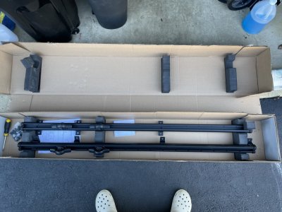

hey guys, just got mopar bed rails and now i have another question.
Does it matter when that rails should be installed? before, after spray-in linings or doesn’t matter?
decided to go with regular line-x btw
The rails us a hex shaped nut-sert that is a tight fit. IIWMT I'd put round head bolts in the holes to keep the spray liner out (It's a bear to trim) and install them after the liner is applied. You'll still need to cut around the bolts to remove them but that's probably easier than trimming and less chance of damage to the paint in the holes.
AFTER................(speaking from personal experience)..................Your going to have to expand the threaded anchors into the holes anyways. You can put cheap bolts in the holes to keep them clean if you want. I too had to drive in the Expanding Anchors, so I chose to have the liner sprayed in first. I chose Line-X Premium Spray In. It has a far better look (plus they offer different colors) and is UV protected, not to mention has a Lifetime Warranty!..:)
