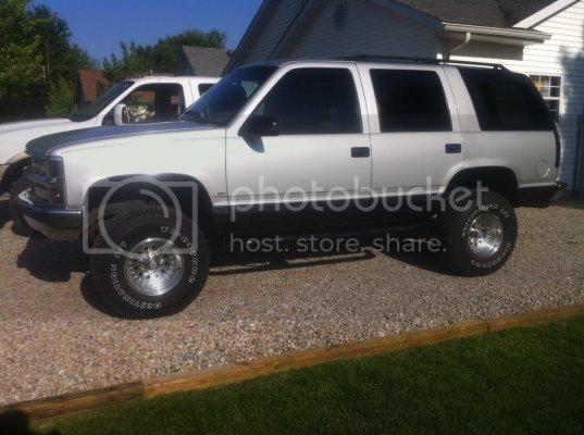

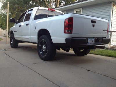

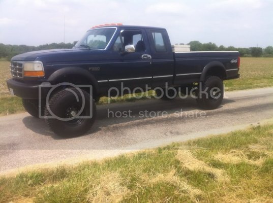

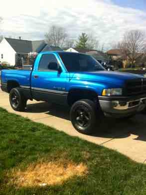

Few pics of my hurc jobs ... All BUT the white ford are my trucks ..

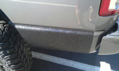

I did mine earlier this week. I used Duplicolor bed armor aerosol cans. It has been a couple of days and is pretty solid. I only did the bottom 6 inches and the bumper because it had some rust.
