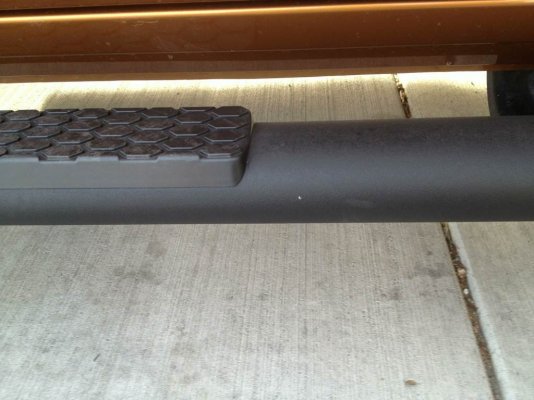

It will come of with a sander. Just gonna hard and dirty. And you probably don't want to breathe that dust either. I'll take some pictures of mine tomorrow and show you how they've held up. Been about four months now. With snow and ice and salt three or four times.

Just scuffed them like you did. But the bars are just chrome-plated some-other-metal. It's just the chrome-plating process makes a pretty durable finish.

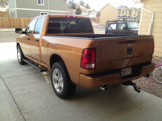

Here's the truck.
Here's the bars. Couple of small nicks in them, but for the time, effort, and money I think they're holding up pretty good. And it would be pretty easy to touch these up.

Oh yeah black wheels would serve that truck well!! And what's that thing you got hiding in the garage back there? ;)

Yeah I've got some DupliColor Shadow I thought about trying. I'm just scared to try. lol
A Corvette that needs a $1,600 set of tires and a battery. :-( lol
